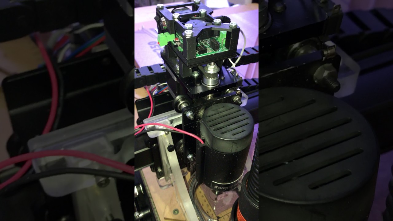

I think the issue is with CNCJS and the way it send the G53 command… After starting the program, this appeared in the terminal screen from the X-Controller:
@KikoLobo Posting this here as well:
That error is likely from a tool change (M6) command. I remove them manually when using cncjs,but you can ignore it (as long as you are comfortable with that error).
The easel post has a 15mm Z-lift after going to a starting XY. Based on your video, you don’t have room for that. Your starting Z-height is only 7.4mm down from your max Z. There really shouldn’t be a reference to G53 in your code at all. Did you look at the g-code and see a G53 somewhere? G53 refers to the absolute machine coordinates. All of your work is done in your WCS, or Work coordinate system.
Try the default grbl post as it will lift to a height set by your CAM operation in Fusion, a combination of “Clearance Height” and “Retract Height” depending on how you have those set up. Your ramping settings could cause those to change as well.
Basically, that foam is too thick for your current settings and setup.
