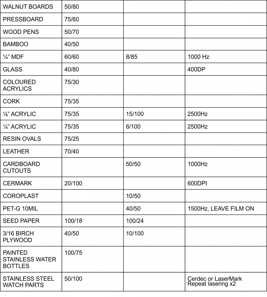

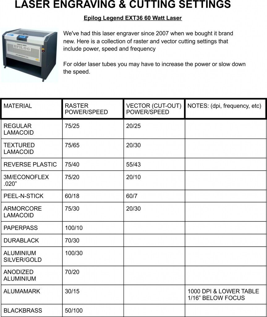

Hi Everyone, we’ve owned a couple of Epilog laser machines over the years and have assembled a collection of settings for materials we’ve commonly processed. The settings are for a 60watt Co2 machine. We’ve moved on to a different manufacturer and process, hopefully, the list can be of use to others.
Cheers.
[![image](https://canada1.discourse-cdn.com/flex009/uploads/inventables/original/3X/c/6/c6c2921bf9aa18dc2058fa99a90e97f9882ef228.jpeg)](https://aranawards.com/wp-content/uploads/2021/02/Epilog-60watt-Laser-Setting_pg-1of2.png)
[![image](https://canada1.discourse-cdn.com/flex009/uploads/inventables/original/3X/3/3/33c2c536a2f06568cc8485c4fff5e9e3a9eeb1c2.jpeg)](https://aranawards.com/wp-content/uploads/2021/02/Epilog-60watt-Laser-Setting_pg-2of2.png)
