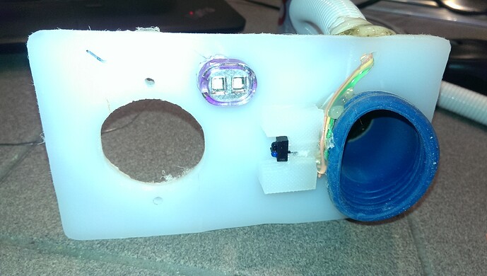

I built a homemade Arduino-based tachometer that will soon permanently mount to my machine. I was able to find a cheap Arduino clone, I nice IR LED/REceiver combo (10 pack), and a tiny, inexpensive OLED display. $12 for the Uno; $2 for the sensor; $10 for a cool readout. I wrote the code yesterday and tested it. Works great. Will mount this weekend. Let me know if you want the details, schematic or code.
I would love to see this device permanently mounted. I might be interested in a similar setup.
Here you go:
Here is the under side. I made the air diverter and dust shoe out of kitchen cutting board (HDPE). The sensor mount is also HDPE and I thought it deserved a little protection under there. The LED light (not necessary but it illuminates the work and makes it easier to see through the clear dust curtain) came from a cheap book light. I used my z-axis limit switch wire to supply five volts to the circuit.
A few things to consider: 1. The wire to the sensor must be shielded. I used a shielded cat 6 cable.
2. The whole thing can be 1/3 the size of mine. You can use the Arduino micro: Amazon.com: OSOYOO ATMEGA328P Module CH340G Mini Microcontroller Shield for Nano Board with Solder pins : Electronics
The code is posted elsewhere but let me know if you want it. I went through four revisions to get a stable reading at >15,000 rpms.
