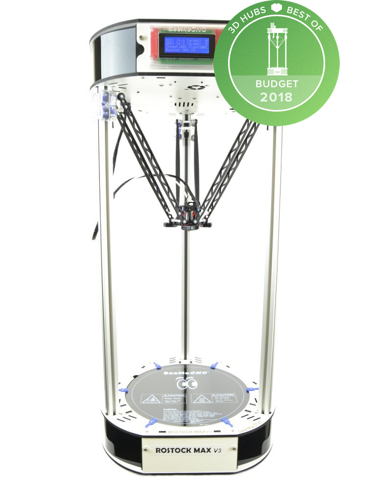

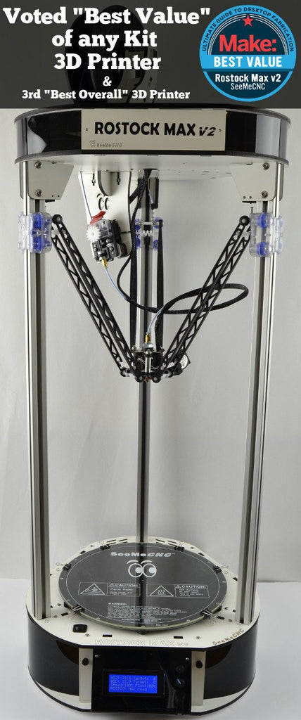

I like this kit:
This is there older version which has twice as many parts but cost $100 less. Good deal!
These are Delta Printers with huge print areas. Nice stuff!!
