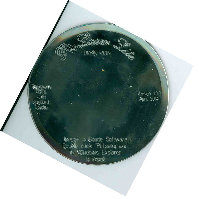

Iāve etched the top surface of a glass mirror with a laser diode by spraying a thin even coat of flat black enamel on it, but have not tried clear acrylic myself. I do think that to cut a clear acrylic is probably not doable with a laser diode. The laser has to be able to burn/heat/melt the acrylic all the way through the thickness rather than just on the surface as when etching. Iāve never worked with a CO2 laser, but maybe others will know.

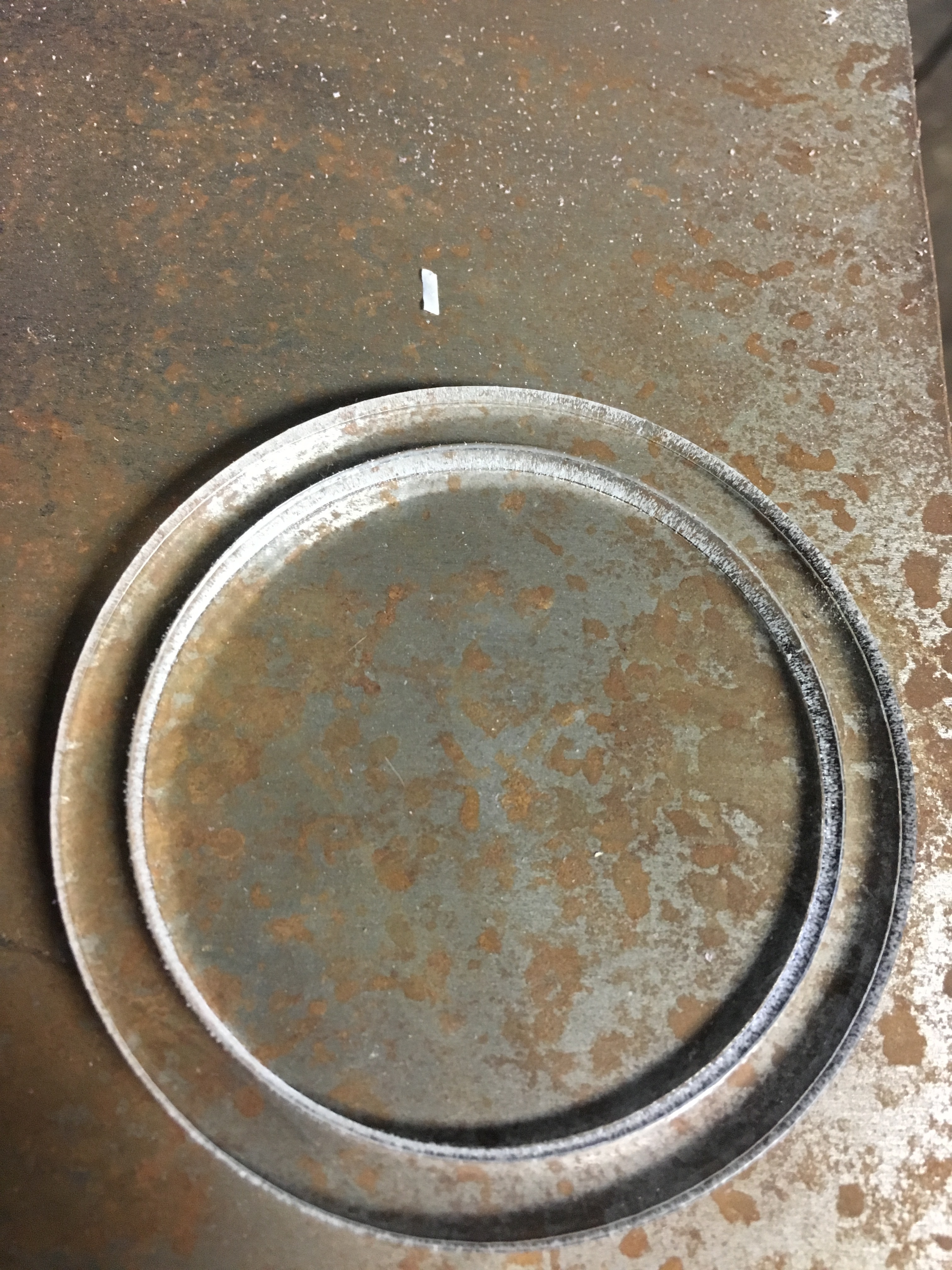

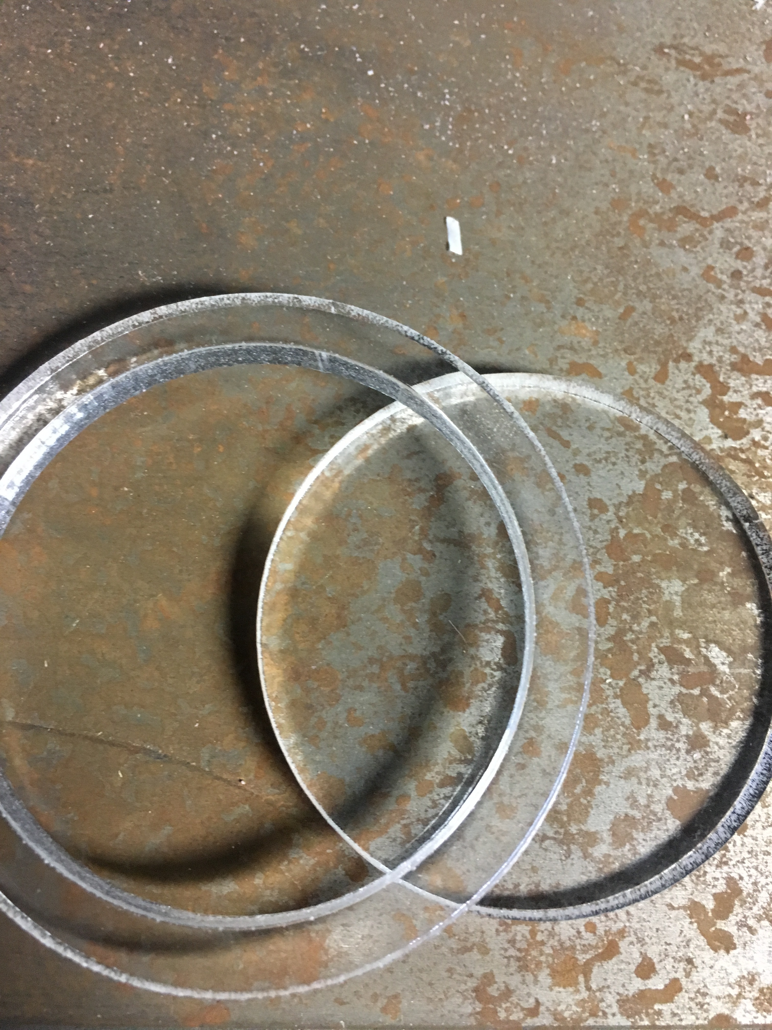

CO2 lasers do a decent job of it. As you can see, even with a commercial model its not a super quick process.
What speed can you cut 3/8" cast with? Can you post a pic of the edge straight off of the machine? It looks like I have a need to cut acrylic now.

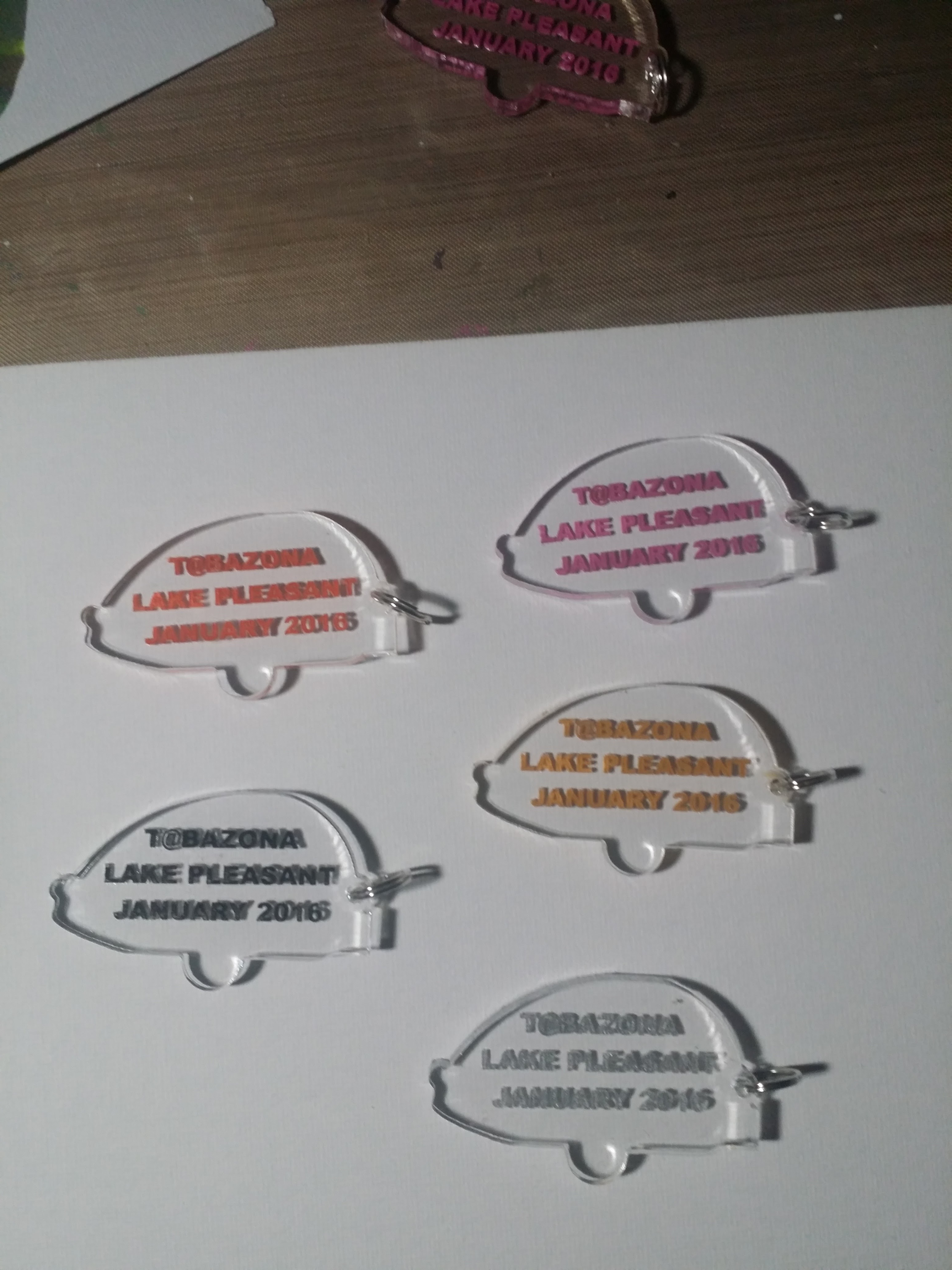

I only have experience with co2 but Iāve done stuff on there they say you canāt do I think itās possible with a jtech. . Itās all about settings. Finding that sweet spot to focus and speed to not burn. If someone with a jtech wants to try my method. Put something under the plastic so it stops the beam and set your focus to just about that material. Your not gonna cut 1/2 material like this but I think it should work with 1/4 and smaller.
Someone else on here had mentioned inverting the image and engraving on the back. I second that looks a lot cleaner.

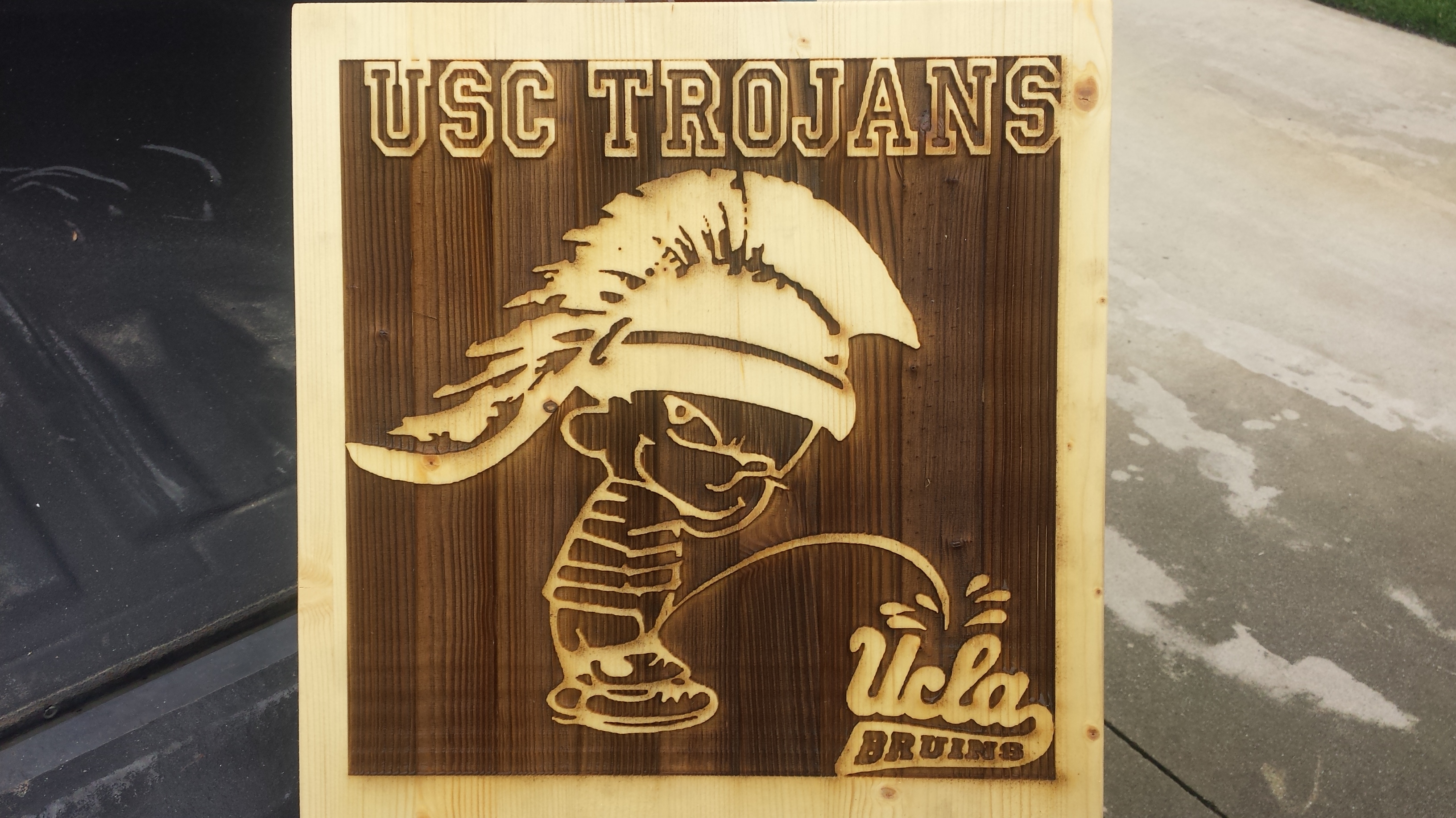

Iām with Robert on the JTech. For engraving I couldnāt be happier. It makes some stunning images on wood. Cutting isnāt its strong point but for me thats not really an issue as I didnāt buy it to cut. For the cost if you mainly want to cut I would say buy the CCL. For engraving and customer support you cant beat the JTech and Jays customer service.
There are a lot of variables that will affect what the edge looks like. They include the speed and material and what power is used. For the most part itās pretty straight and can be cleaned up with a torch.
