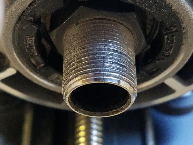

When i try to tighten the collet, it bottoms out with both 1/4 and 1/8 shaft bits. using the collet that came with the router
I got a new collet set from Precise Bits, haven’t had a problem yet.
I just ordered my new collet from them, I will send this router back for warranty and buy a new one for back up

Just happened to me as well. I originally thought it was the collet, ordered a 1/4’’ and a n 1/8’’ from Elair but it didn’t fix the runout problem. After looking REAL close at my spindle I saw that crack. Still under warranty. Going to take it to the Dewalt service center and in the meantime get a new one from Lowes. I can always use a stand-alone router, plus I’ll have a spare.

I noticed my spindle was burning bits and a closer inspection confirmed the spindle was not running true, an even closer inspection revealed that I too had a cracked thread/spindle.

I broke 2 spindles, pretty sure it was the stock collet. I switched to the Precise Bits collet and have not had a problem since.

Just found out today, that I also have a cracked spindle. It was suddenly not cutting clean, or accurate for size. The bits were getting hot as well.
After checking all my belts, pulleys and screws, I finally tried checking the run-out on the spindle. After a couple of tests and a close examination, I found the crack.
I am going to contact Dewalt about warranty, (I bought it last November). If it’s warrantied and how long it takes, decides if I have to go get a new one.

Also at the site I teach at we have had 3/3 of these things break in the same way. After the first, I’ve been real careful with tool changes and it still happened.
I was using the collet adapters that came from inventables (the ones where you put a 1/8" bit and it makes it fit the 1/4" collect) and a bunch of downcutting endmills that all measured in at 0.1250". Something is definitely weird. If this keeps happening I would encourage inventables to recommend adding the 1/8" collet to the recommended items to purchase with these x-carves.
