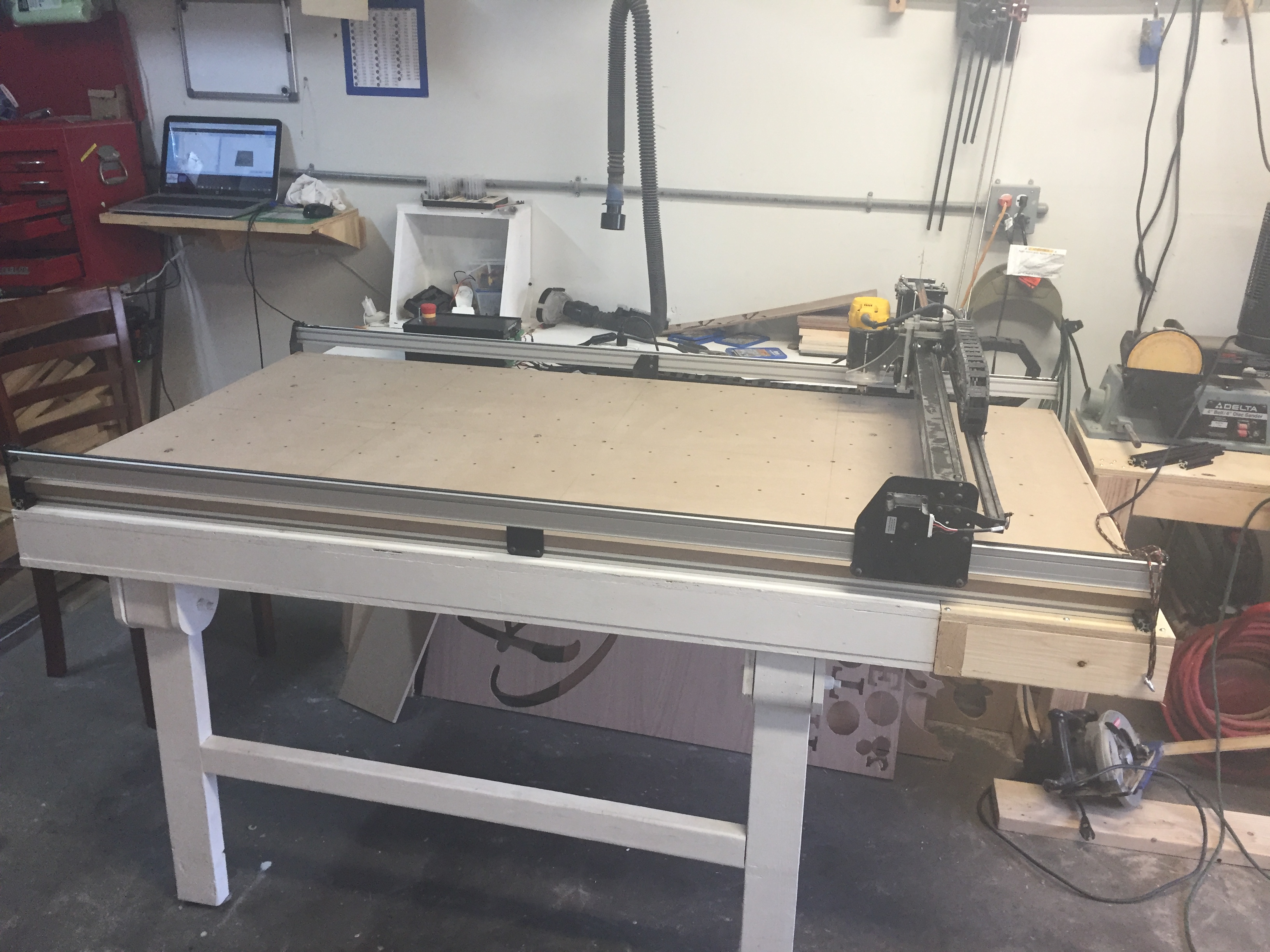

I just finished making mine 1800x1000 today it was kind of a wing it as I went project but I just need to put a piece of 1/2 on top and skim it cause right now there are quite a few high and low spots on the wasteboard
That’s awesome. I’ve been swamped at work since after Christmas so I haven’t had time to get going on mine. I’ve only got the 2 1800 makerslides ordered. I was gonna start the switchover and then order what I needed as I went. Any pointers on anything you quirky you may have run into?
I tried to use as much as I could from my stock one the only rails I ordered was the 1800 makerslides then I got the 20x40x1800 extrusions and cut them down I was a little worried about cutting the extrusions but I just used my miter saw with a 60 tooth blade and cut great but I was able to make the whole thing not buying any extra hardware and reused most of the pieces it was a long weekend I just have some high spots of .05 or less but if I skim it that should fix it I hope I don’t do anything super precise a lot of cutouts and v carved signs

Did you find 1800mm 2020 extrusions? For the base
Did you have to modify any of the wiring?
I did it the ghetto way I spliced and soldered each wire you could probably use longer wires and use new connectors but you will have to make the wires longer
